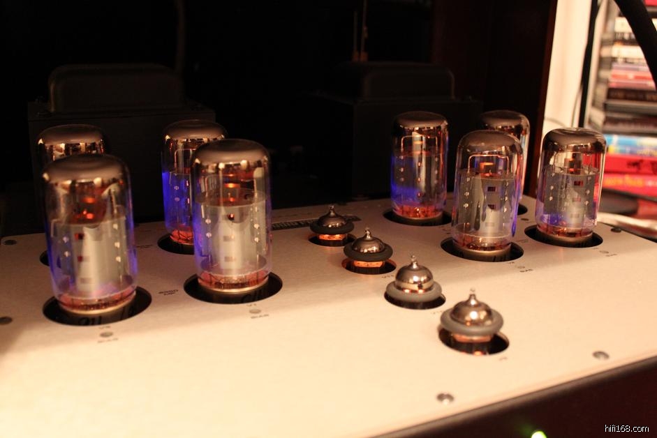

刚入手ARC VM220后级,慢慢煲吧
(205.70 K)
2011/5/3 3:05:06
(199.07 K)
2011/5/3 3:06:29
