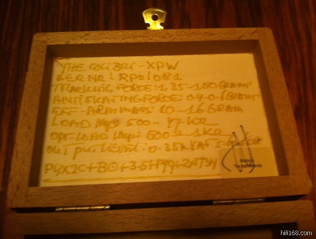

娥也抓了只鸟,前来报到一下。
最后编辑庄园 最后编辑于 2013-02-20 00:16:58
本主题由 版主 eric 于 2011/1/23 23:35:44 执行 设置精华/取消 操作
我的小鸟头标称:
负载阻抗:500~47K;输出负载阻抗:500~1K;输出电平:0.35mv。
问题:1、它的线圈直流阻抗是多少?2、升压牛的初级阻抗如何选择?
收到范登豪先生的回复:
The average moving coil resistance of the 4 layer platinum coil is around 500 Ohm DC impedance.
There might be a small variation in this impedance thanks to a minor difference in coil-wire length.
The impedance setting of your input device must therefore minimal be also 500 Ohm.
Where the secondary load is 50 KOhm, your input transformer should have a ratio of 1 : 10.
There are not many of these transformers around, so evaluate your transformer for this specific property.
With a lower input impedance, the sound will lose transparency in the top-end and also dynamics are gone.
And most important: the output level drops down dramatically.
Wish you many happy listening hours,
With Best Audiophile Regards,
A.J. van den Hul.

Dear,
The impedance of 500 Ohm is the result of the 4 layer Platinum coil. A two layer has an impedance of around 250 Ohm (just half of the 4 layer impedance).  But the output is also 50% of the 4 layer output. To have enough output, minimal 0,35 mV at 5,6 cm/sec, a 2 layer coils creates a problem ()based on the higher coil impedance combined with the lower output). It might be hard to understand, so I am very open for a better solution.
With a primary load of minimal 500 Ohm and a secondary of 50 KOhm, the ratio must be 1 : 10. With the.WE618B, the ratio is  1 : 6,45 what is not enough even where there will be sonic output. Your sound quality is not what you can expect from your Colibri XPW or XPP.
With Best Regards,
A.J. van den Hul.
用升压牛的话,范老头推荐使用500:50K,10倍变比。
